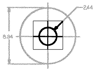

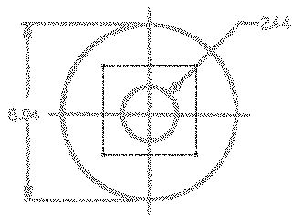

The following region object includes all the pixels within the selection rectangle: the circle, the portions of the intersecting lines, and the leader line.
Rectangular region selected
Region object defined from the selection
