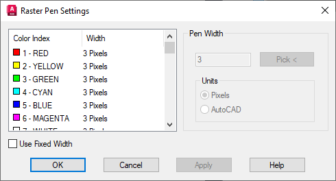

When you merge vectors, you can select raster pen widths for the merge by specifying pen thickness in the Raster Pen Settings dialog box.
Raster pens apply a specified line width to vector entities when you merge them into the image. Line widths are assigned according to entity color.
