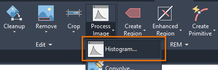

Select image 1 and zoom in on it. On the ribbon, click Raster Tools tab Edit panel Process Image drop-down menu Histogram.
If prompted to proceed, click Yes.
Press Enter to process the entire image.

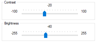

3 In the Histogram dialog box, click the Brightness/Contrast tab. Adjust the Brightness and Contrast sliders, noting the effects in the Preview. Choose a setting that improves the image visibility. Click Apply, then click Close.

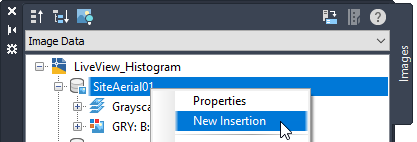

6 If you want to try using different histogram controls to edit the image, insert additional copies of the image. To do this, ensure that Image Manager is open (if necessary, on the ribbon, click Raster Tools tab Manage & View panel Manage). On the Image Manager, click the drop-down list and choose Image Data. Expand the LiveView_Histogram node, right-click SiteAerial01 and choose New Insertion.
A new insertion is created over top of image 1. Move the new insertion to a different location in the drawing.
