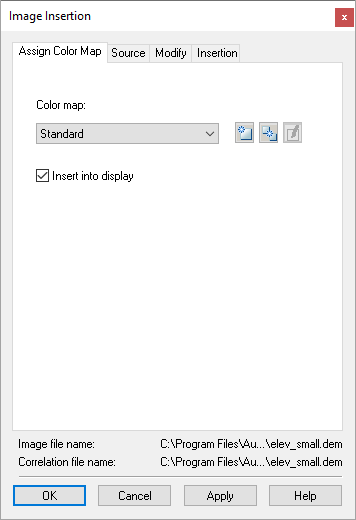

Satellite imagery and other multispectral data includes a separate image for each data band within the file set. For example, the set can include images for red, green, blue, and infrared data bands. Using a band assignment color map in AutoCAD Raster Design toolset, you can combine different bands to highlight particular features of the image data.
You can use the Image Insertion dialog box to assign a data band to each color channel and decide which channels to include in the display. At any time, you can change the band assignment and view the results on the screen.
