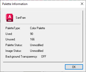

- In the
Palette Manager dialog box, click
Palette menu
Information. The
Palette Information dialog box shows that only 90 of the possible 256 colors are being used and that background transparency is not activated for this image. Click
OK.

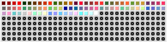

- Click
View menu
Show Unused. The unused colors in the palette are marked with an X through them.

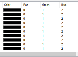

- In the Sort By list, select Luminance. The palette display reorders with the darker colors at the end.
- Place the cursor over the last (darkest) button in the color table, with an
Index of 0. In the status bar, the
Frequency is 0, indicating that this color is not used in the image.
The color at Index 0 seems to be a good choice for the transparent color but you should verify that there is not another index in the image that uses this color.
- Click the Index 0 button in the color table. Scroll to the bottom of the list window. The Index 0 line is highlighted and none of the other dark colors in the list exactly match the RGB and
Frequency values. This indicates that black is a “safe” color to use as the transparent color.
Note: Even if there were other indices using the color black, it could still be used as a transparent color as long as all the instances were unused. - Click Set Transparency. The display updates to show this as the assigned transparent color.

From the palette display, you can see a large number of unused colors. By compressing the palette, you eliminate unused colors. Compress also changes the indices in the image so the used colors are grouped together at the top of the palette.
- Click
Compress to eliminate the unused colors in the image.
