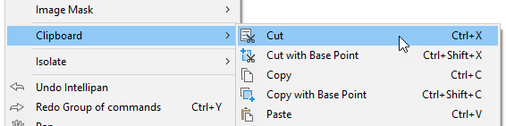

3
Select the border of the REM region, right-click and choose Clipboard Cut.
The window outline is deleted, leaving a red X to mark its bottom left corner.

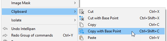

Use another connected fence to create an enhanced bitonal region for window 1.
Select the REM region, right-click and choose Clipboard Copy with Base Point.
5
Click the bottom left corner of window 1 to specify the base point, right-click, and click Clipboard Paste.

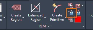

6
Click the REM window 2, and then on the ribbon, click Raster Tools tab REM panel Merge To Raster Image.
REM window 2 is converted to raster.
