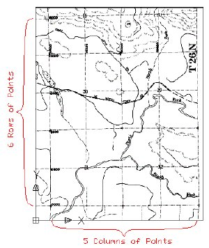

  5. Note that the image contains 6 rows and 5 columns of points that would approximate the grid contained in the image. In the Grid Parameters dialog box, Points section, enter 6 for Rows and 5 for Columns. Note the total number of points in the grid is shown so you know how many points can be used in the rubbersheet operation.
    This example shows the rows and columns in the image.
