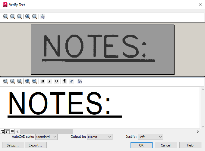

- Draw a rectangle around the word “NOTES” as follows: click the upper left corner, press
Enter to set the angle to 0, then click the bottom right corner.
The Verify Text window displays the word NOTES: in both the View pane (upper pane) and the Edit pane (lower pane). If the word NOTES: is not underlined in the Edit pane, click and drag to select the word and click the underline formatting option on the Edit toolbar. If the recognition engine has inserted any unwanted characters, delete them from the Edit pane.
- Click
OK to insert the word NOTES: into the drawing as AutoCAD MText.
The following example shows how the MText displays in the drawing.

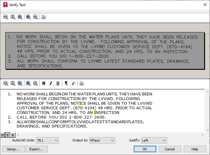

- Enter s at the command line to display the Text Recognition Setup dialog box.
- Change the following settings:
- In the Input section, select the check boxes for Uppercase, Numbers, Punctuation, and Miscellaneous.
- In the AutoCAD Output section, set the Output Type to MText and set AutoCAD Style to TR1.
- In the Verification Display section, clear the formatting check boxes and select Enable Verifier.
- Draw a rectangle around steps 1 through 3 as follows: click the upper left corner, press
The Verify Text window opens. The View pane displays the original raster text; the Edit pane displays the output from the recognition engine.
- Review the areas of highlighted text in the Edit pane. Click
Find Next to display the first suspect word or rejected character in the
Change To box. Select a word from the
Change To list or enter the correct word in the box and click
Replace. Click
Add to Dictionary if you want to add the word or acronym to the recognition dictionary. When you click
OK, you are prompted to add the word to the AutoCAD custom dictionary too.
Attention: Because no recognition engine is 100% accurate, you should carefully check the results in the Edit pane, not just the highlighted areas, and make all necessary changes.
- After making changes, click
OK to insert the new AutoCAD MText in the image and then press
Esc to end the command.
If necessary, you can use standard AutoCAD commands to move or edit the text.
