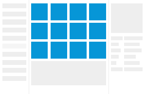

Outcomes
The middle pane displays thumbnails of the outcomes generated by the study.
Above the pane, use the controls to do the following:
- display outcomes as thumbnails or a list
- sort by a selected metric in ascending or descending order
- display the next page of thumbnails

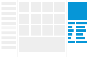

Details
The right pane displays details of the outcome that is selected in the middle pane. It shows the variables and constants used to generate the outcome, as well as the resulting outputs.
If the details pane doesn't display, select the Details option above the pane.
To see the previous and next outcomes, click the left and right arrows at the bottom of the pane.
Use Create Revit Elements to integrate the selected outcome into the model.
