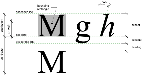

Text Measurement
In Revit 2017 and later releases, the method for measuring text size is changed so that the Text Size parameter more accurately represents the height of a capital letter (similar to AutoCAD). Previously, Revit measured the size of text from the font baseline to the ascender line. Since most characters do not extend to the ascender line, physically measuring the font may not have produced expected results.
The size of text now reports using the cap height, which measures from the baseline to the top of a capital letter M. It is important to note that many Asian characters are somewhat taller than the capital letter M, so these characters appear taller than the Text Size parameter value for Western fonts. Adjust the Text Size parameter to make these characters the desired height.
This change affects all text in Revit. After upgrading a model, review all views and sheets to verify the changes to your text instances.
Note: Be sure that the proper fonts are installed when opening an upgraded model. Substituted fonts further will change text due to the font sizing changes.
