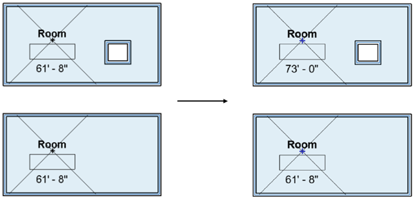

Room Perimeter Calculations
The method used to calculate room perimeter values has been updated in Revit 2025 resulting in improved accuracy. Specifically, perimeter calculations now provide more precise measurements for rooms with inner loop boundaries, accurately accounting for the inner loop perimeter.
Additionally, the method for calculating the perimeter of round rooms or room with arc segments has been enhanced to ensure greater accuracy.
Please note that when upgrading models from earlier versions of Revit, it is possible to observe changes in the perimeter values of rooms, depending on the geometry involved.
