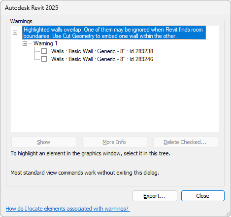

Find Warnings for a Selected Element
You can display a list of warnings related to an element.
  1. Select an element in the drawing area.
  2. Click Modify tabWarnings panel (Show Related Warnings).
    Note: If the element has no warnings, the Show Related Warnings tool does not display on the Modify tab.
The list of warnings displays in a tree view.
Expand items to see the individual elements associated with each warning. When you select the text next to a warning, the element highlights in all open views where it is visible.
To delete an element from the model, select the check box next to an element name, and click Delete Checked.
