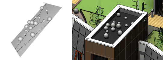

Use this sample study type with Generative Design in Revit to place a randomized set of family instances on a selected face given a base family type, density, and randomization seed.
The left image shows an outcome in Generative Design. The right image shows the outcome when it's integrated into the Revit model.
With this sample study, you can explore placement of family instances on faces. Examples include placing art objects outside a building model or placing flowers in a sloped bed in a landscape model. A version of this sample is also available in Dynamo Player.

When viewing the outcome in the Details pane of the Explore Outcomes dialog, you can drag the 3D view to see the elements from different angles. To see it in a 3D view of the model, you must integrate the selected outcome into the model.
