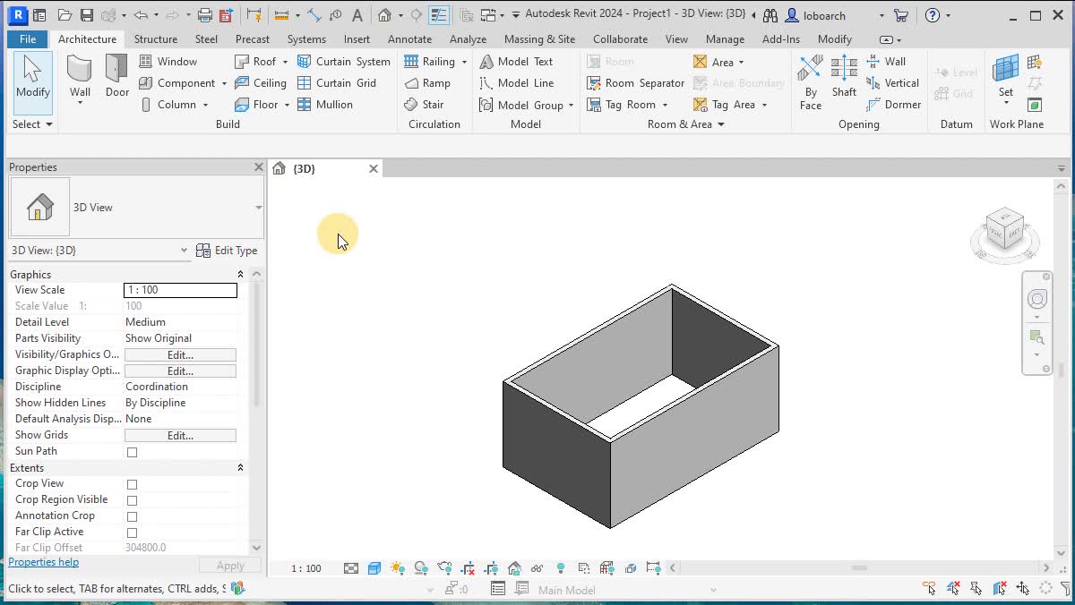

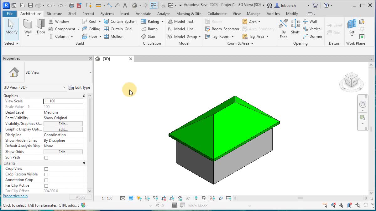

Hip Roof
All edges of the sketch are set to be slope defining.
