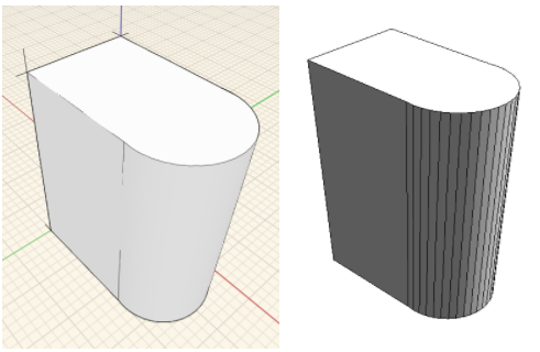

  • Curved faces in FormIt are imported to Revit as faceted faces.
