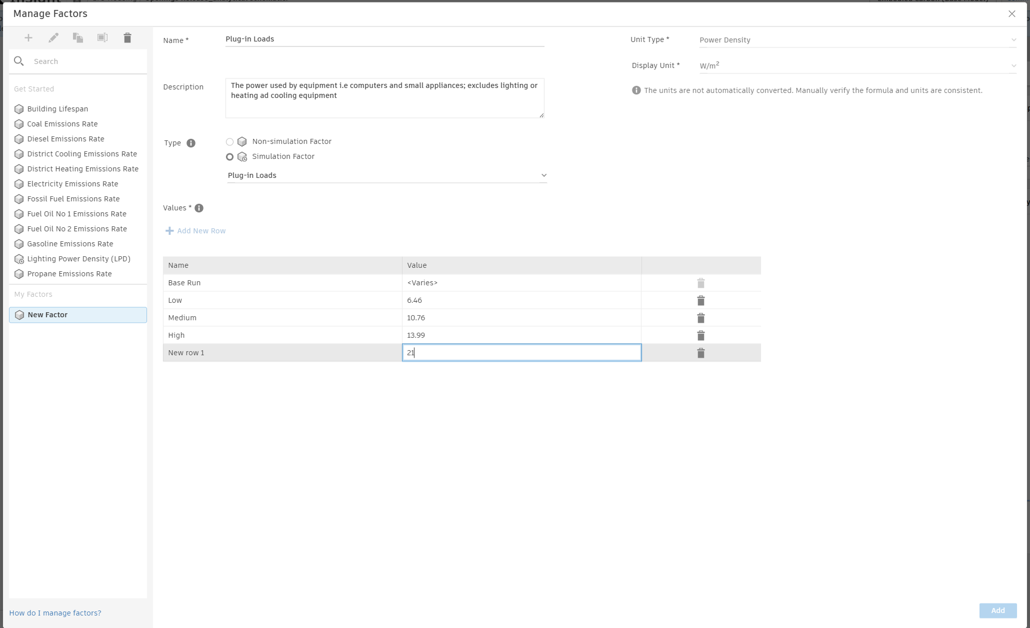

  1. From the navigation bar in the upper right, select 'Manage Factors'.
  2. In the Manage Factors dialog, click the + icon.
  3. In the Factor Information section of the dialog, provide the following details:
  • Name
  • Unit Type
  • Description
  • Display Unit
    Note: Name, Unit Type, and Display Unit are required fields. Names must be unique.
  • Type
    • Non-simulated factor - The results fo the factor are immediately reported in the dashboard.
    • Simulated factor - An additional simulation must be performed on the model in order for results to display on the dashboard. For additional information see Simulation Factors.
      Note: Display Units are not editable when simulation factor is selected.
  1. In the Values section of the dialog, edit or add values as needed. add values
    Note: Factor value will be set with a dropdown card on a custom dashboard. Provide a minimum of 1 and a maximum of 5 values for a factor.
  2. Click 'Add' to create the Factor.
