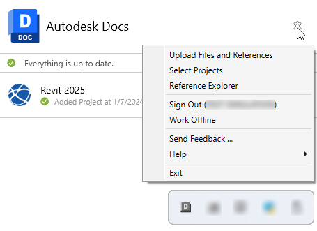

After installing Desktop Connector, the Autodesk Docs connected drive will display. This connected drive can be used to link or open supported file types from within Revit.
Autodesk Docs
