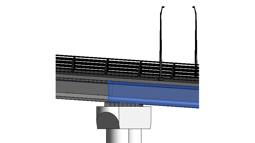

New categories to better support bridge design in Revit. This feature supports the Civil Structures Workflow with Autodesk InfraWorks and Revit.
This update includes a new filter for the infrastructure category, making it easier to find and use infrastructure-related categories.
In addition to the filter, 26 model categories and 20 annotation categories have been added. These categories support visibility/graphics overrides, object styles, schedules, and tags.
