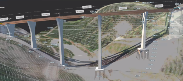

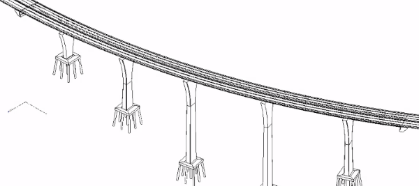

Update Bridge and Tunnel Geometry from InfraWorks
Update a bridge or tunnel model geometry when the design is changed in InfraWorks.
  1. Publish model changes from InfraWorks.
    Note: Before publishing changes from InfraWorks save the Revit model locally first.
  2. Once the model from InfraWorks is updated, a notification will be delivered to Revit on the pending update.
  3. Click Apply in the notification dialog to apply the updates to the Revit model.
  4. (Optional) Click Ignore in the notification dialog to ignore the updates. Click Check for Updates on the Add-Ins tab to display the notification again when you are ready to apply the updates to the Revit model.
