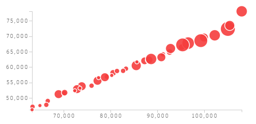

If you pick an option for Size, the points in the graph will display in different sizes. For example, after Box 1 Height is selected for Size, the size of the point represents the height of box 1 in the outcome: Larger point means higher box height, and smaller point means lower box height.
Scatterplot with drop-down options selected for x-axis, y-axis, and size

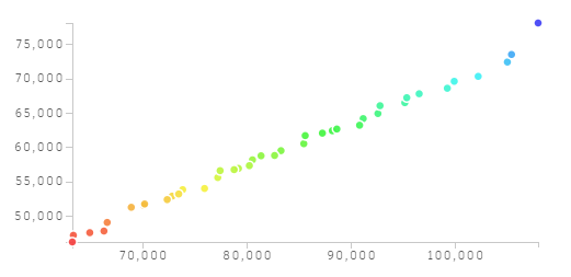

If you pick an option under Color, the points in the graph will display in different colors, from red (low) to blue (high). For example, after Surface Area is selected for Color, the color of the point represents the size of the surface area in the outcome, ranging from red (smallest) to blue (largest).
Scatterplot with drop-down options selected for x-axis, y-axis, and color
When an option for each drop-down is selected, the chart displays data in four ways: y-axis, x-axis, color, and size. In the example below, y-axis represents surface area, x-axis represents floor area, size of a point represents box 1 height, and color of a point represents box 2 position y.
