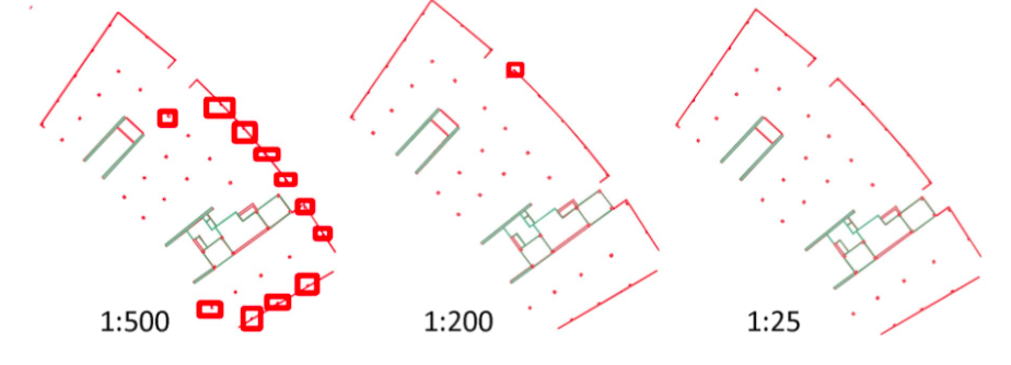

Previously, when a view scale exported to DWG, DGN, or DXF, was large (more than 1:200,1:500, 1" = 1/16'. 1" =40', and so on), the resulting export could have missing lines and small model elements. This issue has now been fixed, with improved export precision.
The following image shows an example of a view exported at different scales. The red revision clouds show objects that were partly missing from the output file.
