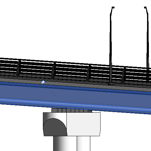

Once in Revit, the model can accept structural reinforcement.

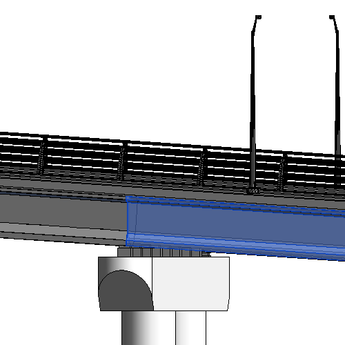

Note: For consistent workflow, when importing geometry into Autodesk Revit use the same units of measurement in your InfraWorks and Revit models. Enable the Infrastructure categories filter in the Visibility and Graphics Overrides dialog to control the visibility and graphics of the imported geometry. - Select the components that require detailing and create parts from them.
- Once parts have been created, the bridge components can be further detailed and included in assemblies like other parts created in Revit.
