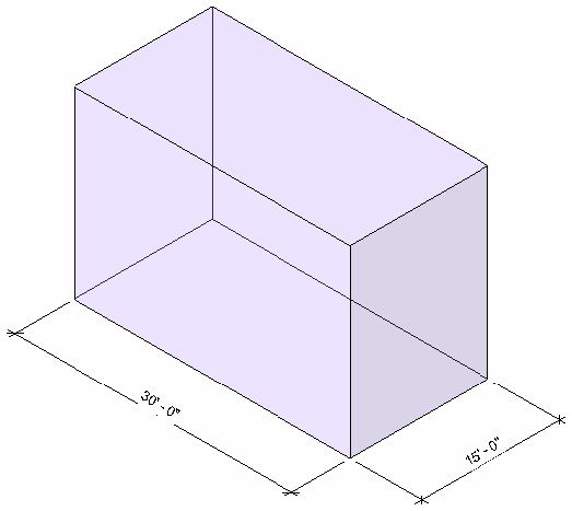

Revit uses extrusions to define 3D geometry for families. You create an extrusion by defining a 2D sketch on a plane; Revit then extrudes the sketch between a start and an end point.
Query the Extrusion Form object for a generic form to use in family modeling and massing. The Extrusion class has the following properties:
Table 40: Extrusion Properties
Property Description
ExtrusionStart Returns the Extrusion Start point. It is a Double type.
ExtrusionEnd Returns the Extrusion End point. It is a Double type.
Sketch Returns the Extrusion Sketch. It contains a sketch plane and some curves.
Figure 81: Extrusion result

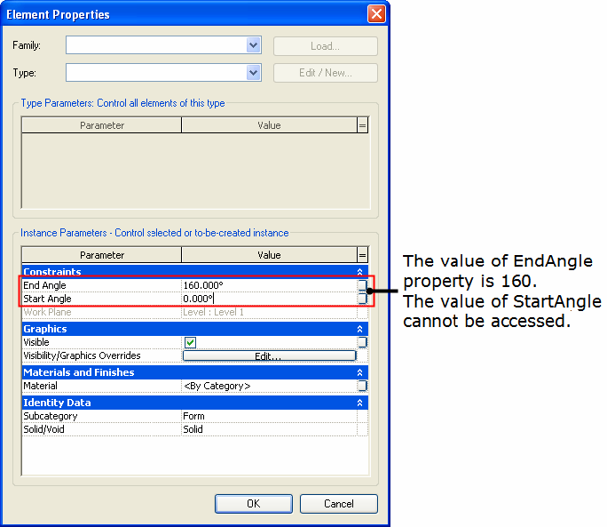

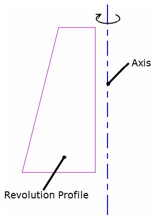

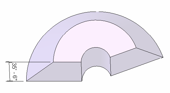

EndAngle is consistent with the same parameter in the Revit UI. The following pictures illustrate the Revolution corresponding parameter, the sketch, and the result.
Figure 82: Corresponding parameter
Figure 83: Revolution sketch
Figure 84: Revolution result

  • The Start Angle is not accessible using the Revit Platform API.
  • If the End Angle is positive, the Rotation direction is clockwise. If it is negative, the Rotation direction is counterclockwise

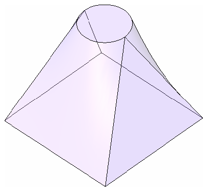

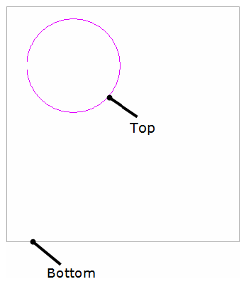

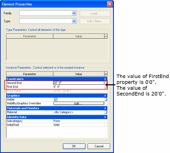

The FirstEnd and SecondEnd property values are consistent with the same parameters in the Revit UI. The following pictures illustrate the Blend corresponding parameters, the sketches, and the result.
Figure 85: Blend parameters in the UI
Figure 86: Blend top sketch and bottom sketch
Figure 87: Blend result

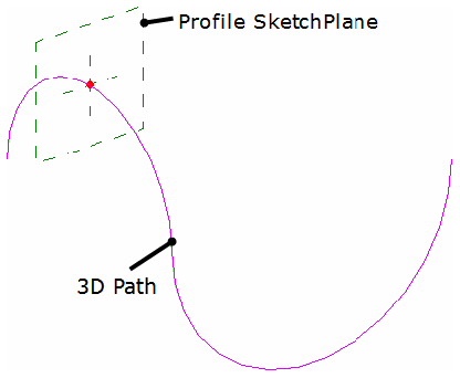

Creating a 2D Path is similar to other forms. The 3D Path is fetched by picking the created 3D curves.
Figure 88: Pick the Sweep 3D path

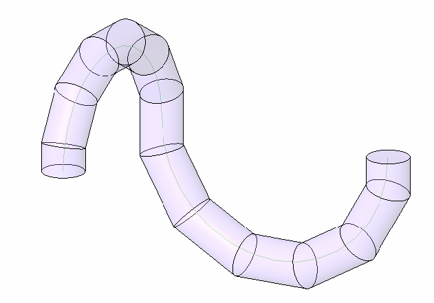

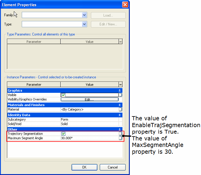

Segmented sweeps are useful for creating mechanical duct work elbows. Create a segmented sweep by setting two sweep parameters and sketching a path with arcs.
Figure 90: Corresponding segment settings in the UI
Note: The following information applies to segmented Sweeps:
  • The parameters affect only arcs in the path.
  • The minimum number of segments for a sweep is two.
  • Change a segmented sweep to a non-segmented sweep by clearing the Trajectory Segmentation check box. The EnableTrajSegmentation property returns false.
  • If the EnableTrajSegmentation property is false, the value of MaxSegmentAngle is the default 360°.
Figure 91: Sweep result
