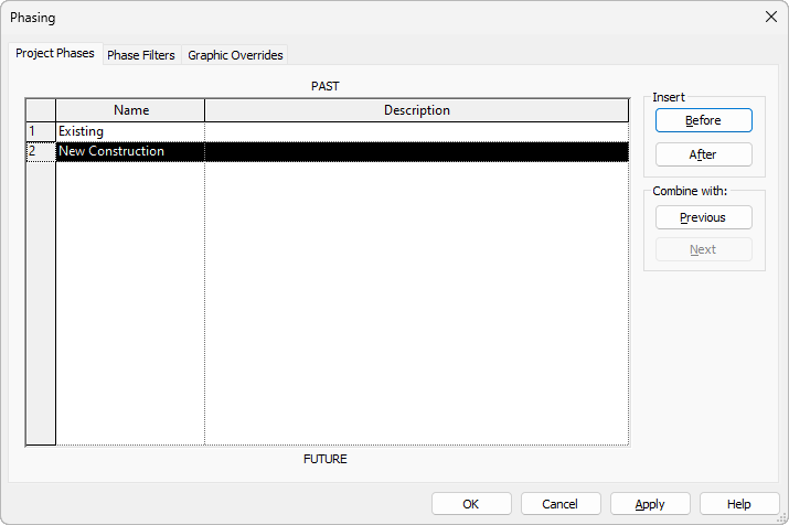

  1. Click Manage tabPhasing panel (Phases).
    The Phasing dialog opens, displaying the Project Phases tab. By default, each project has phases called Existing and New Construction.
  2. Click the number box adjacent to a phase.
    Revit selects the entire phase row. The following image shows the New Construction phase selected.
  3. Insert a phase.
    Attention: You cannot rearrange the order of phases after you add them, so be aware of placement.
    To insert a phase before or after the selected phase, under Insert, click Before or After.
    Revit names the phases sequentially as you add them. For example: Phase 1, Phase 2, Phase 3, and so on.
  4. If desired, click the Name text box of a phase to rename it. Similarly, click the Description text box to edit the description.
  5. Click OK.
