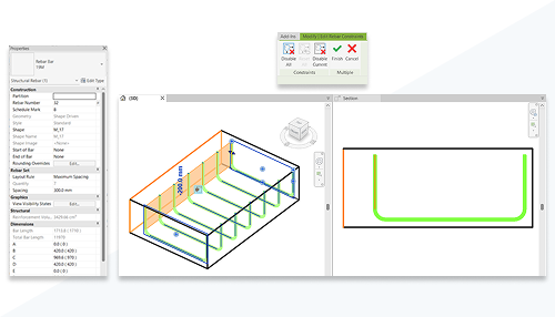

Edit rebar constraints with property adjustments, undo/redo capabilities, and seamless view switching.
- Edit the rebar properties while editing the constraints.
- Undo and redo changes during rebar constraint editing.
- When editing constraints for multiple sets, the changes are applied for all the sets in the selection.
- Easily switch views while editing rebar constraints.
For additional information, see Edit Rebar Constraints.
