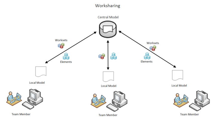

Worksharing is a design method that allows multiple team members to work on the same project model at the same time.
On many projects, team members are assigned a specific functional area to work on.
Team members share a central model
Revit projects can be subdivided into worksets to accommodate such environments. You can enable worksharing to create a central model so that team members can simultaneously make design changes to a local copy of the central model.
