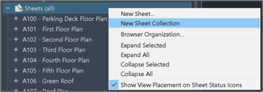

To create a Sheet Collection, in the Project Browser Sheets, click New Sheet Collection.
Every sheet includes the Sheet Collection parameter, which lists all the collections in the model.

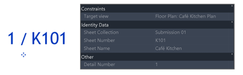

  • The Sheet Collection name is prefixed to the sheet number and name in the view tab tooltip.

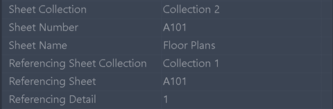

  • The read-only parameters Sheet Collection and Referencing Sheet Collection are available for compatible view types in Revit, alongside the existing sheet and view parameters.
  • ·Sheet Collection and Referencing Sheet Collection parameters can be utilized in compatible view filter categories (Elevations, Sections, Callouts, View References) and Schedules (Sheet List and View List).
  • Sheet Collection and Referencing Sheet Collection parameters are available in applicable family categories (View Titles, View References, Callout Heads, Elevation Marks, Section Marks, Title Blocks) so they can be utilized in labels.

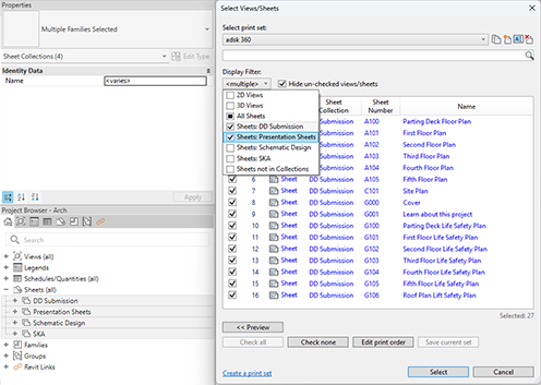

  • The Export\Print dialog includes each Sheet Collection as a dedicated display filter toggle, to support precise selection of sheets in one or more collections.
