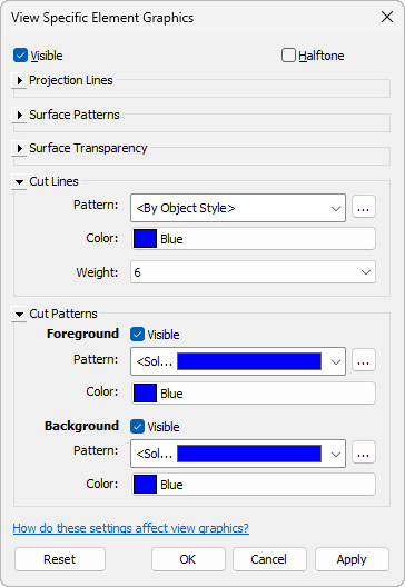

Override Graphics in ViewBy ElementHalftone

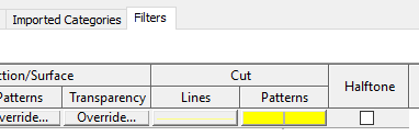

View Filters

A wall has the following overrides:
  • Visibility/Graphic Override for the Walls category for the view
  • Override Graphics in ViewBy Element for the wall instance

  • View filter overriding the graphics for walls over a specific thickness
With the 4 overrides defined, the element override on the wall instance is visible because it is the highest in the hierarchy:
Remove the element override and the view filter is visible:
