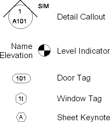

Sample Symbol Legend
The following symbol legend identifies the annotation symbols that are used in a set of construction documents.
