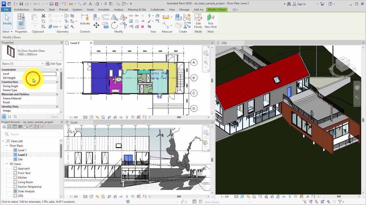

Video
This video demonstrates the following:
  • Place an instance of a door family in a model.
  • Replace the family with a different door using the Type Selector.
  • View instance and type properties for the family.
  • Create a type using the Duplicate function in the Type Properties dialog.

This video demonstrates how to place a family element in a project and view the properties for the element. All of the elements in a project are families.
A family contains the graphic information, plan, elevation, section, and 3D views used for an element. When you place a model family into a project, the family displays in all views of the model. Revit includes a library of content from which you select families and load them into your project. Usually, you can replace a family with a different family by using the Type Selector on the Properties palette.
The families also contain non-graphic information in the properties of the element. When an element is selected, instance properties display on the Properties palette. Instance properties contain information related to that specific instance of the element in the model. The type properties of a family are applied to all of the elements of the same type in the model. Create a new family type by duplicating an existing type and making changes to the properties.
Use the instance and type properties of families to specify and track information about the elements in your project.
