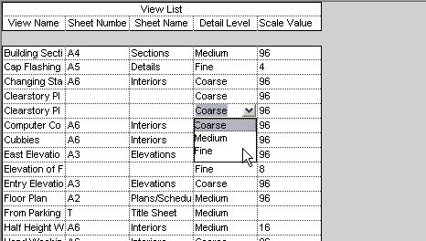

A view list is a schedule of the views in a project.
In a view list, you can sort and group views by type, level, sheet, or other parameters. If desired, you can include view lists on sheets. (See Schedules on Sheets.)
View lists can help you to do the following:
  • Manage views in a project
  • Track the status of views
  • Ensure that important views display on sheets in the construction document set
  • Ensure that views are using consistent and appropriate settings
You can use a view list to see and modify parameters for multiple views at once. For example, suppose you include the Detail Level and Scale parameters in a view list. From the view list, you can change the detail levels of selected views to coarse, medium, or fine, or change view scales to use consistent settings. You can also change the view name or view title that displays on sheets. By using a view list in this way, you can identify and correct inconsistent view settings from one location.
