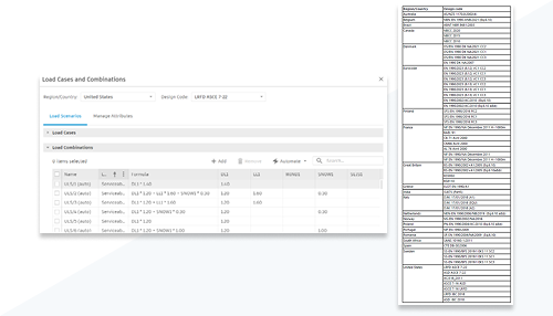

Structural Engineers are now able to automate the load combinations creation process based on the selected design code.
You can use the Automate Load Combination generator based on a selected Region/Country and Design Code.
| Region/Country | Design code |

For additional information, see Automate Load Combinations.
