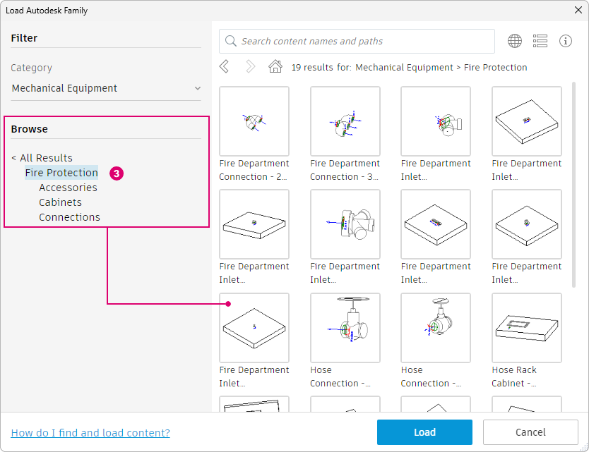

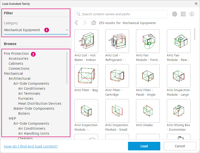

Filter/Browse
Set a filter on the left side of the family browser window. At the top, select a category , only elements in that category are displayed in the items window. For example, you might select the category "Mechanical Equipment". Within the Mechanical Equipment category, there are numerous items sorted into several groups, Fire Protection, Mechanical, and Plumbing . The groups are further sorted into sub-groups. The Browse section of the filter allows you to refine the filter using the groups and sub-groups. Select a heading and the number of items displayed is refined . Click titles in the tree to navigate back through the list.

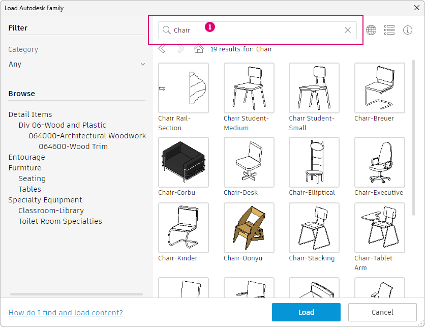

Search
The Search bar at the top of the family browser window allows you to search the items currently displayed. The search tool searches both the name of the family and the folder path where the file is located. If the search term is found in either of those places, the item will be listed in the browser.

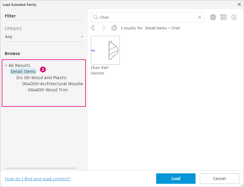

It is important to remember the search tool works on the items currently displayed in the browser. Combine a search with the filter tools to locate a specific family. For example, without a filter applied, a search is done for "chair" and several chair families are listed. There is also one detail item, chair rail profile. If the detail items group is selected as a filter under Browse before the search was done, only the chair rail detail item is displayed in the search result .
