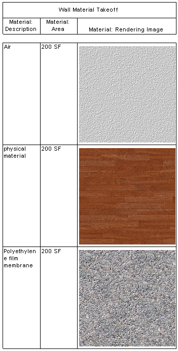

This example demonstrates how to create a wall material takeoff schedule with images, but you can use the same procedure to create a material takeoff for other element types.

  11. Create a Wall Material Takeoff schedule and include the field Material: Rendering Image.
  12. Create a sheet view, and place the Wall Material takeoff schedule on the sheet. The Wall Material Takeoff schedule viewport displays with the images on the sheet.
