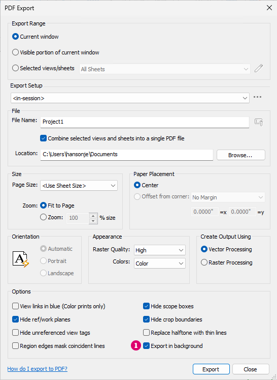

Enable Export in Background
Exporting PDF files in the background allows you to continue working in your model as the export process takes place.
Background processing of PDF exports enabled in the Options section of the Export dialog . Export in Background is off by default.
See Export a PDF File for more information on the workflow to export a PDF file.
