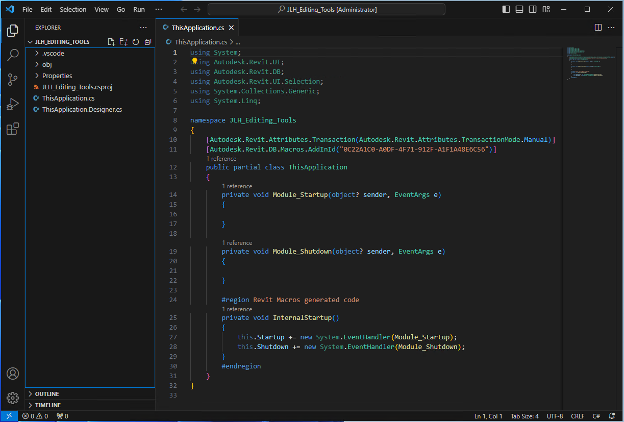

- In the Macro Manager dialog, select a module and click
Edit.
A session of Visual studio Code launches to write the macros. It displays a starting template for the macros in C#.
For example, uses a C# template for application-level macros, the session of Visual Studio Code has already:
- Included the necessary using directives.
- Identified the module namespace (JLH_Editing_Tools in the graphic below).
- Started the ThisApplication class definition.
- Started the methods for Module_Startup() and Module_Shutdown().
