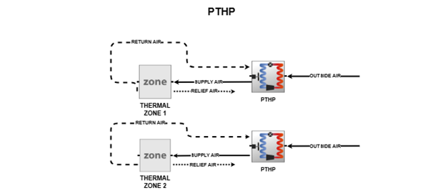

Packaged Terminal Heat Pump - This system consists of a Packaged Terminal Heat Pump (PTHP) serving each conditioned thermal zone. The default ASHRAE Standard used to set the efficiency of regulated equipment is ASHRAE 90.1-2016.
system diagram
Packaged Terminal Heat Pump (PTHP):
Quantity: 1 per conditioned Thermal Zone
Capacity: Auto-sized
Cooling: Provided by DX cooling coil
Heating: Provided by DX Heating Coil
Heat Pump Controls: Based on Capacity and ASHRAE Standard
Cooling and Heating Efficiency: Based on Capacity and ASHRAE Standard
