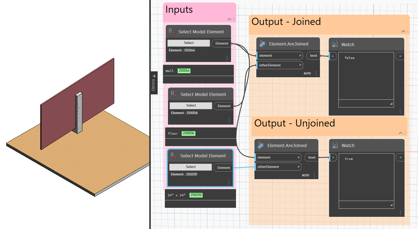

| Element.AreJoined |
Check whether the two elements are joined. |

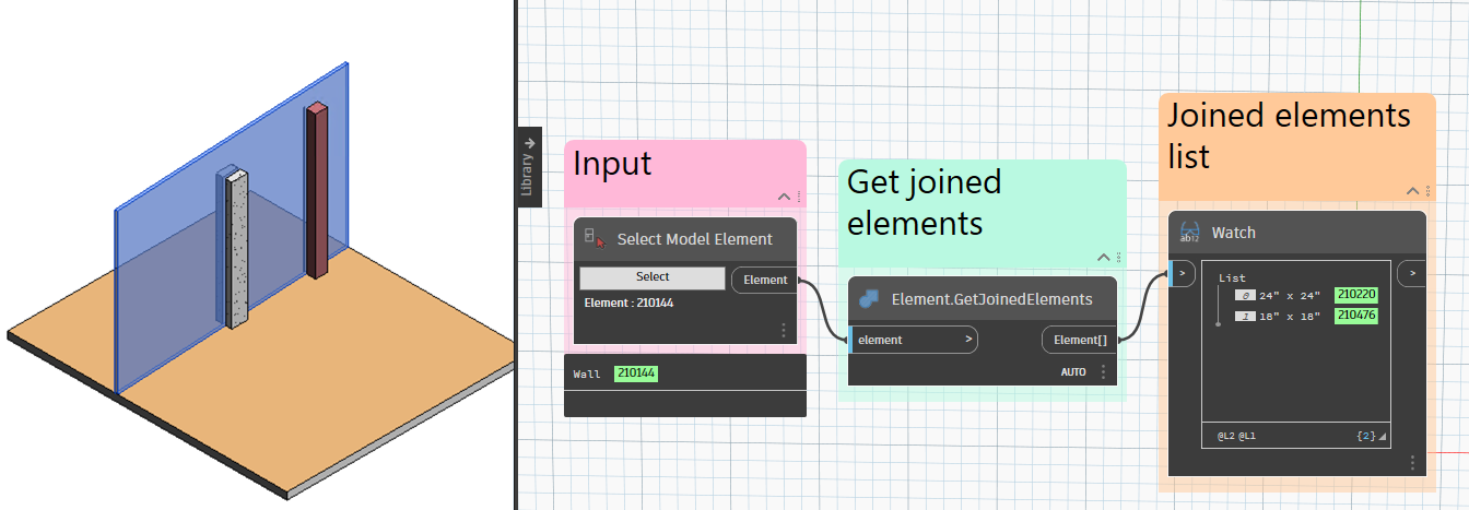

| Element.GetJoinedElements |
Get joined elements to select them. |

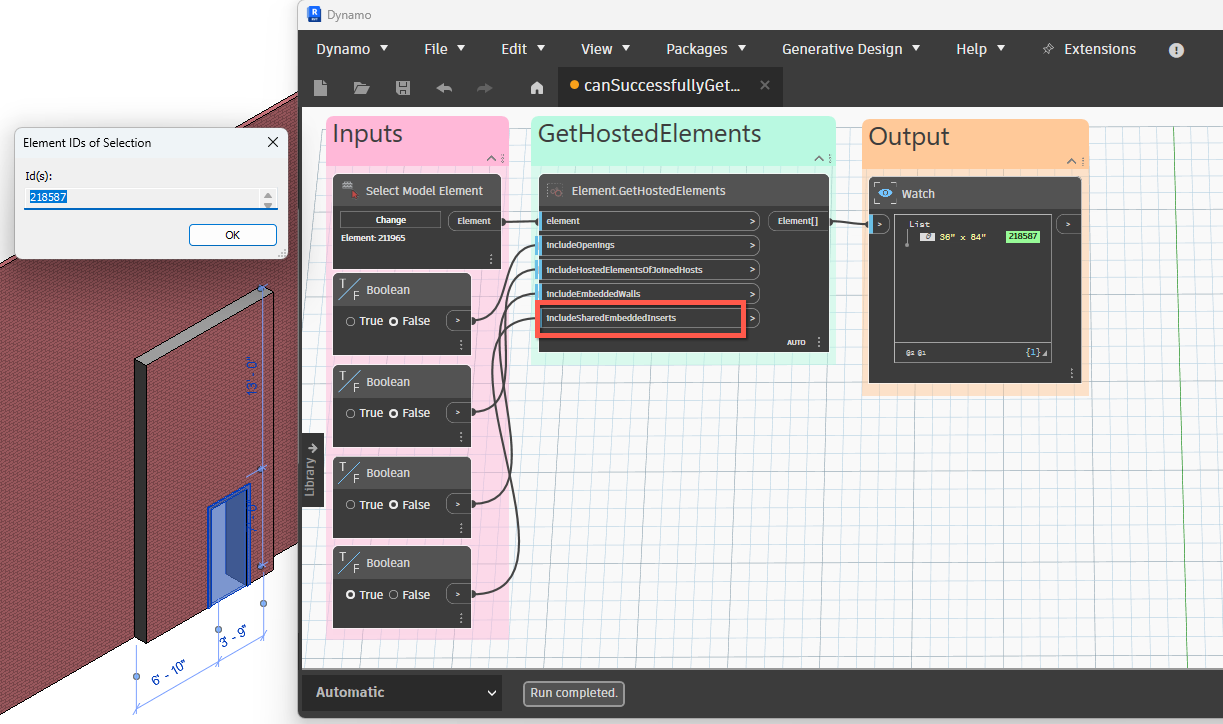

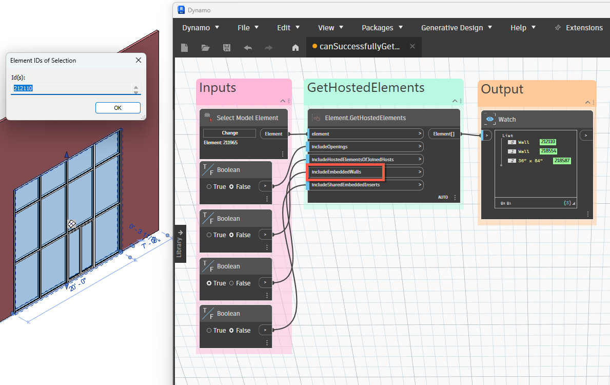

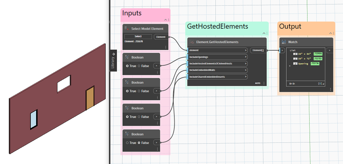

| Element.GetHostedElements |
Collect all the content that is hosted to the element. |
| IncludeOpenings |
Get all hosted elements, such as openings, windows, and doors. |

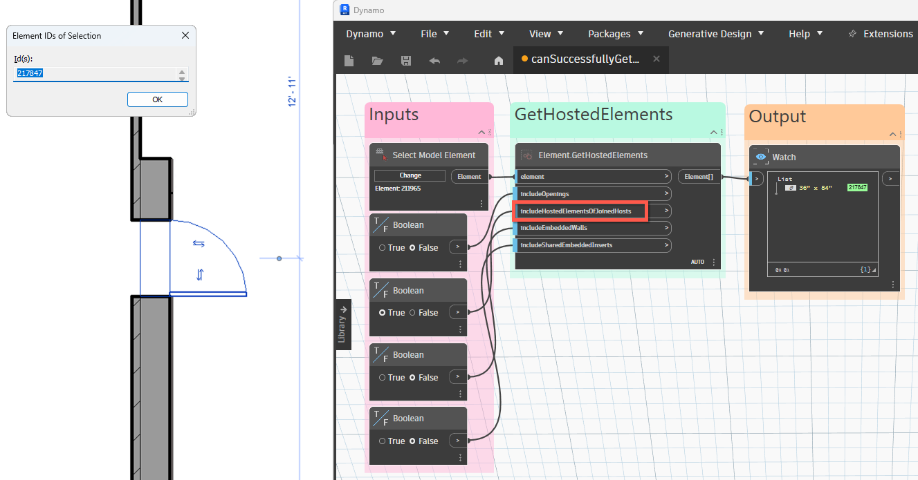

| IncludeShadows |
Use this node when two walls are joined (by Modify->Geometry->Join), and a door is placed on one of the joined walls. If includeShadow is set to true, then Revit returns the door element ID. |
| IncludeEmbeddedWalls |
Get the entire embedded wall or curtain wall. |
| IncludeSharedEmbeddedInserts |
Get the door, window, or other inserts that are hosted in the embedded wall. |

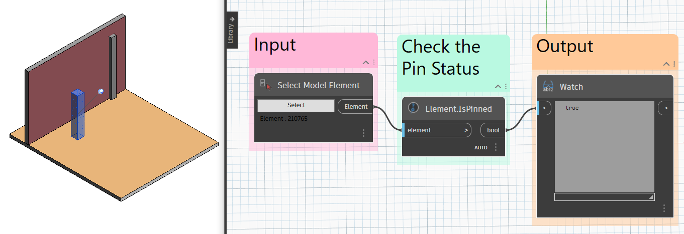

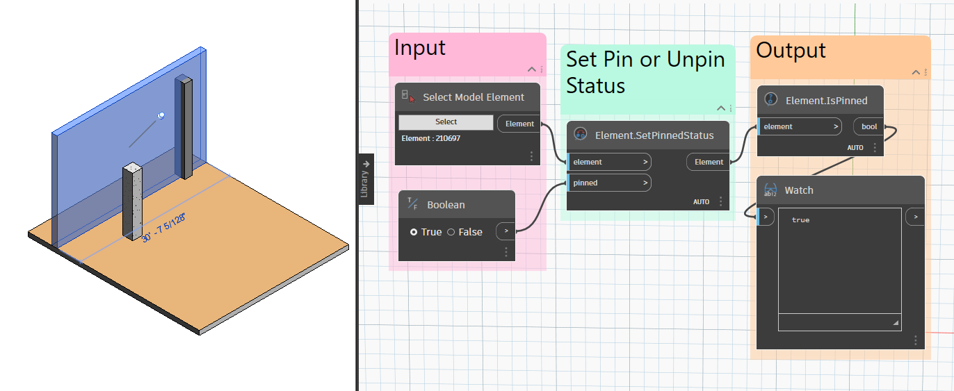

| Element.SetPinnedStatus |
Set pinned status: True to pin, False to unpin. |
| Element.IsPinned |
Query whether an element is pinned. |

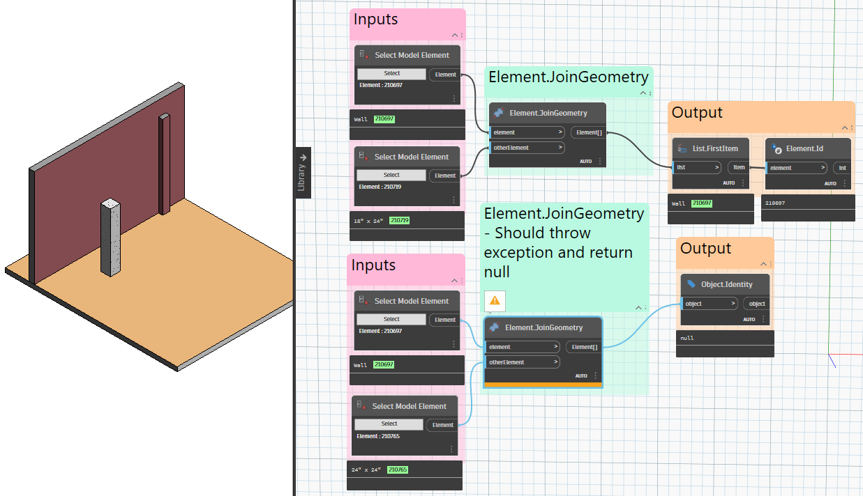

| Element.JoinGeometry |
Join two intersecting geometrical elements. |

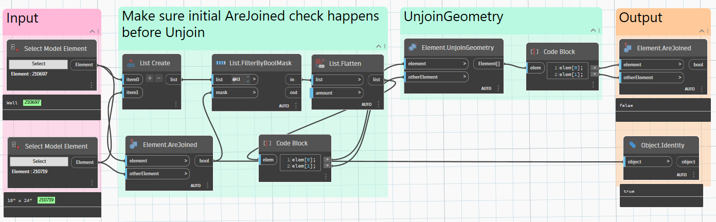

| Element.UnjoinGeometry |
Unjoin two intersecting geometrical elements. Feed in two elements. If they are joined, then unjoin them. |

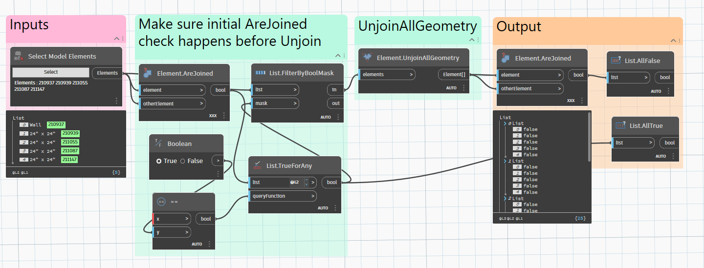

| Element.UnjoinAllGeometry |
Unjoin a list of intersecting geometrical elements. Feed in a list of elements. If they are joined, then unjoin all of them. |

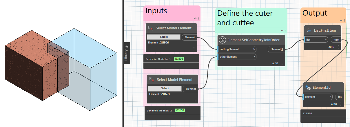

| Element.SetGeometryJoinOrder |
Switch the join order of geometry. Feed in two elements (or a paired list) and switch their join order. Note: This node does not apply on the multiple wall joining order. |

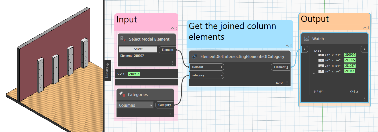

| Element.GetIntersectingElementsOfCategory |
Take an element and collect all intersecting elements of a chosen category. |
