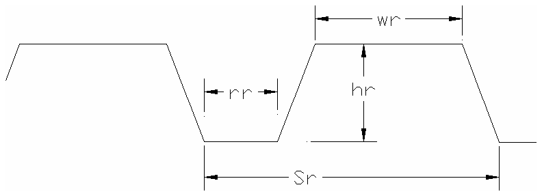

How do I view the true deck layer?
  • There is an example in the SDK called DeckProperties that provides information about how to get the layer information for the deck. The deck information is reported in exactly the same way as it is in the UI. The deck dimension parameters are shown as follows.
