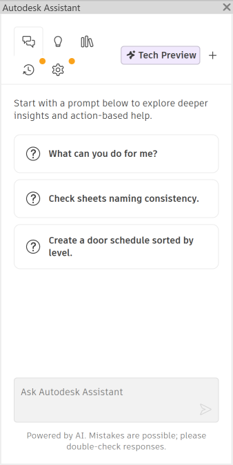

How can I access Autodesk Assistant?
  1. In Revit, sign in with your Autodesk account.
  2. Click the icon next to the InfoCenter in the title bar to open the Autodesk Assistant panel.
Autodesk Assistant in Revit menu
Alternatively, you can click View > User Interface > Autodesk Assistant.
Note: Autodesk Assistant is typically open by default when you are signed in. If you don’t see the Autodesk Assistant tool, close and restart Revit.

What can Autodesk Assistant do for me?
The Assistant can currently support Contextual Help (e.g., “How do I create a section view?”), Model Query (“Find all doors on Level 1”), and Model Modification (“Create a floor plan for Level 2”) prompts. Just click the suggested prompt “What can you do for me?” to learn more.
Autodesk Assistant for Revit panel
