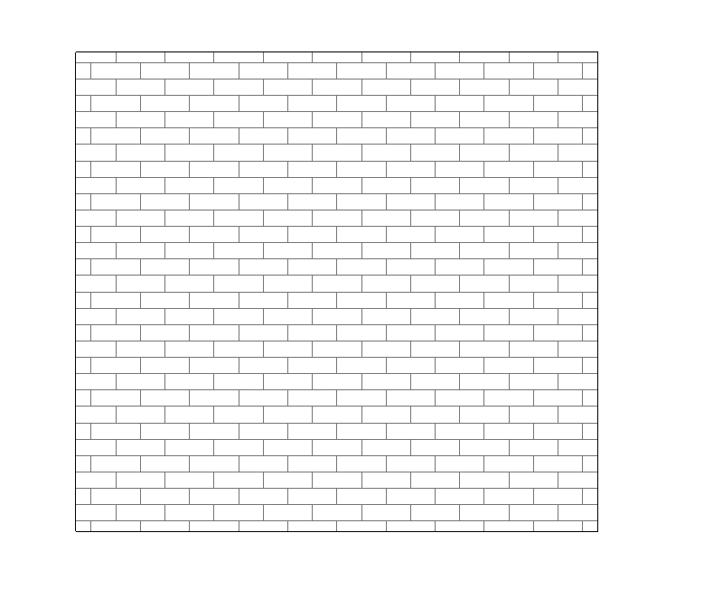

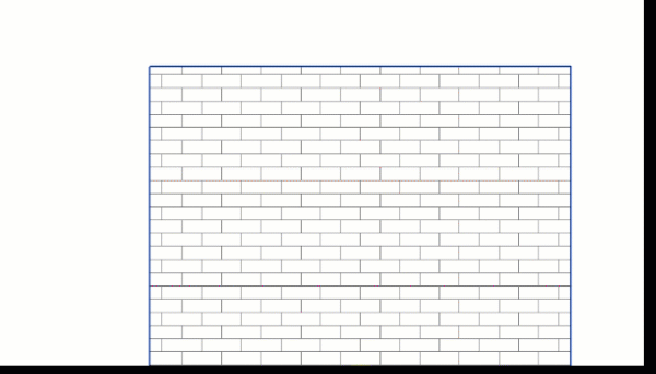

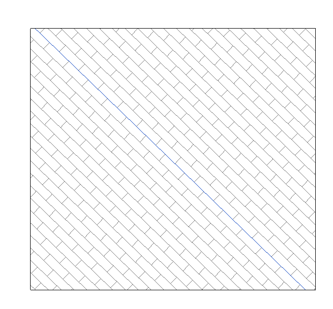

Example
Floor with model pattern
Rotating pattern
Floor pattern after rotation
