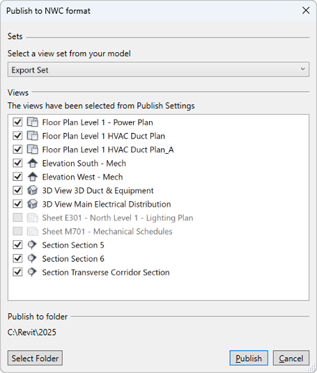

  1. Click Publish to NWC in the Add-ins tab on the Revit toolbar.
  2. Select the view set that you want to export from the drop-down menu. The views associated with selected view set will be displayed. Views that cannot be exported to NWC format will be unchecked and disabled. If a specific view is not required for export then it can be unselected by unchecking the tickbox on the left side of the window.
  3. To change the exported file name of the view, click on the view name and enter the name to use for export.
  4. The publish folder will be automatically set to the same location from which the Revit file was opened. To change the publish folder, click Select Folder and select the folder you want to use.
  5. When you're ready to publish, click Publish. The progress bar will show the current export status. When all views have been exported, the progress bar will disappear.
