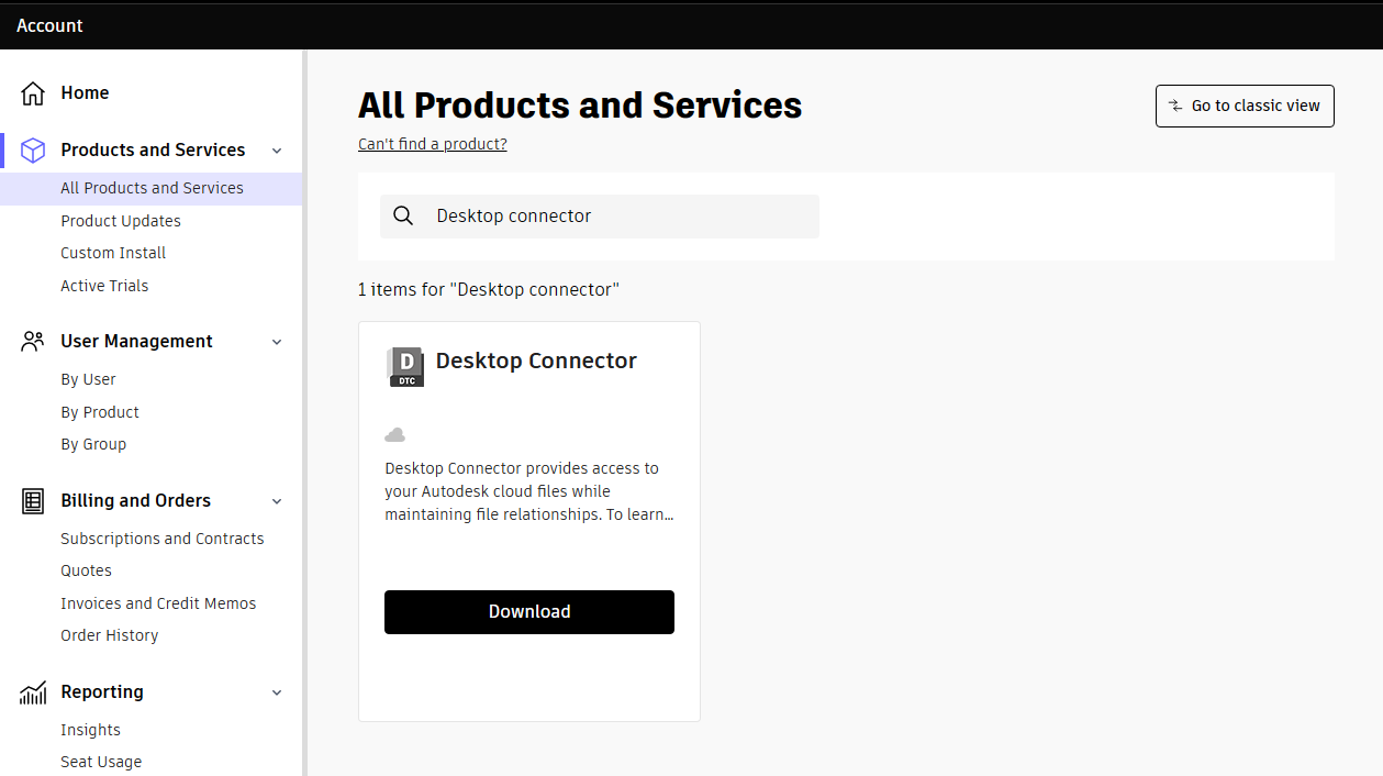

Warning: A Desktop Connector update is required in order to continue.
Issue: To access files on connected drives, you must have the most recent update installed.
Solution:
  1. To download the latest version, go to Autodesk Account Products and Services. Desktop Connector appears under Products and Services.
  2. From Desktop Connector, use the Check for Updates option to update the application.
  3. After the update completes, launch Revit LT and confirm that links from connected drives load as expected.
