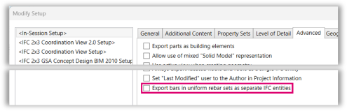

Rebar sets with bars of the same length are now grouped together when exported to IFC.
  • The new default behavior for uniform sets is to select the entire rebar set when inspecting the IFC model.
  • Bars in varying rebar sets are exported as individual IFC entities.
  • Use the option to export bars in uniform rebar sets as separate IFC entities:
For additional information, see IFC Export Setup Options.
