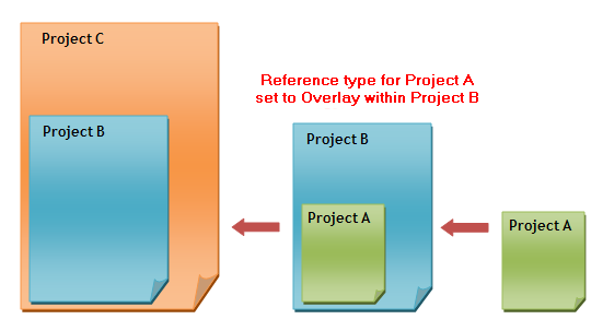

  • Overlay does not load nested models into the host model, so they do not display in the project.

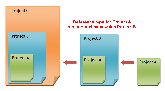

  • Attachment loads nested linked models in the host model and displays them in the project.
The following image shows that Project A is linked into Project B (so Project B is the parent model for Project A). The Reference Type setting for Project A is set to Overlay within its parent model (Project B). When Project B is imported into Project C, Project A does not display.
If you change the Reference Type setting for Project A (within its parent model, Project B) to Attachment, when you import Project B into Project C, the nested link (Project A) displays.
