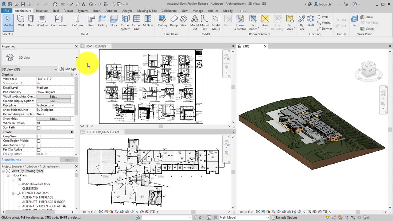

This video demonstrates the following:
  1. Save a non-workshared model to the cloud
  2. Save a publish change to the model.
  3. Review the model on Autodesk Docs.
Note: This video was recorded using Revit 2019. When performing the procedures using Revit LT, you may notice minor differences in functionality and user interface.

Cloud workflows can help you share your project with team members and streamline collaboration across all phases of the project. Enable Autodesk Docs cloud workflows by first saving a model to Autodesk Docs.
To save a non workshared model to Autodesk Docs, on the File menu select Save As and choose Cloud Model. In the Save as Cloud Model dialog, use the controls on the left to select the correct project, then navigate to the folder where you want to save the model and click Save. Once a model is saved to Autodesk Docs, subsequent saves, will update the model on Autodesk Docs.
On Revit Home a model saved to Autodesk Docs is indicated with an icon. You can also view the model in the location on Autodesk Docs using the navigation controls. To make the latest changes visible on Autodesk Docs, publish the model.
Once the published, view directly in Autodesk Docs in a browser or a mobile device. Autodesk Docs workflows such as model coordination or review and markup can now take place with your Revit model on Autodesk Docs.
