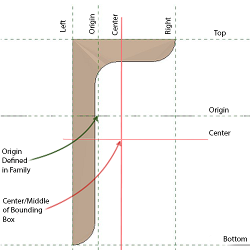

In some cases, the family origin of a structural framing element may not align with center of the bounding box of the element.
The following illustration shows the difference between the origin of the family geometry as opposed to the center of the bounding box.
