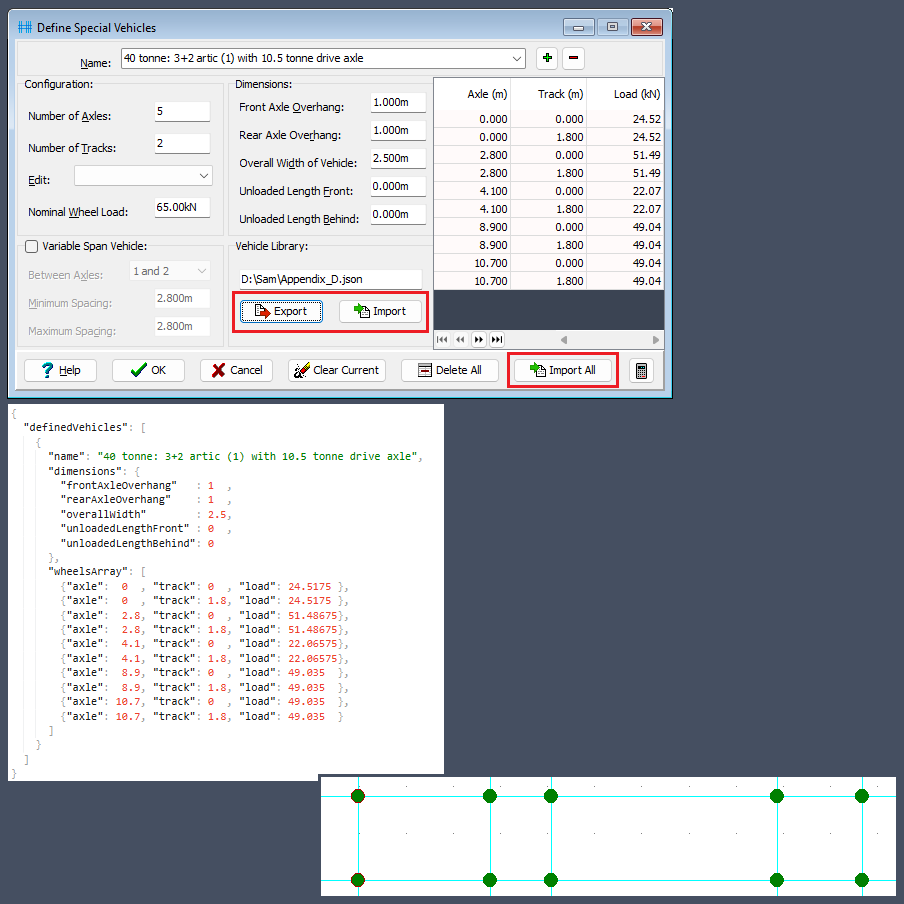

User Vehicle Library (What's New in 2026)
User Vehicle definitions for traffic loading can now be imported and exported in JSON text based format, in addition to the existing binary format method.
Automation
In addition, all vehicles in the library file (JSON or binary) can be imported at one time using the Import All button.
For additional information regarding the JSON format, refer to this help topic.
