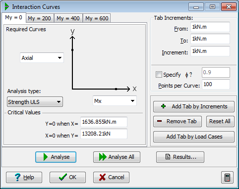

For the three action effects of axial load (Ax), bending about the x axis (Mx), and bending about the y axis (My), a plot may be produced of the section at capacity for any two of the three effects for a given value of the third. There are therefore 3 possible combinations of axes (ϕ*Ax / ϕ*Mx; ϕ*Ax / ϕ*My; ϕ*Mx / ϕ*My), and the x and y axes may be interchanged making a total of 6 possible configurations for the plot.
The procedure is first to set the axes to the required two action effects, then if the third effect is to be non-zero, or a range of values are required for the third effect, to set appropriate 'Tab' values using the 'Tab Increments' panel, and clicking on the Add Tab by Increments button or the Add Tab By Loadcases button (which only creates additional tabs if the third effect varies). The number of points on each curve may be varied from the default value up to a maximum of 100 points depending upon the resolution required.
Calculation is initiated when the F6 key is pressed or by clicking on the Analyse button. A comprehensive series of data checks are carried out before the analysis takes place, and appropriate warning messages issued. The interaction curves can be viewed in tabular form by pressing the F5 key or clicking on the Results button.
One graph is generated for each tab and the graph corresponding to the current tab is displayed. These can be viewed by changing the current tab and, if not previously analysed, calculating the new graph. The graphs for all the tabs may be calculated at the same time by clicking on the Analyse All button.
The fields labelled 'Critical values' show the values at the intersection with the x axis and y axis.
Note that the value of the third action effect on the tab cannot allow for the variation in the strength resistance factor ϕ that is inherent in analysis for differing combinations of the other two effects. An appropriate allowance should therefore be applied to the tab value.
For some column geometry and combinations of axial load and bending the iterative algorithms that are required for the solutions may not converge. In this case an interpolation is made between adjacent points on the curve which have successfully converged, and a message is issued after the analysis is complete stating how many points have been interpolated in this way.

Required Curves (X and Y axis)
Select the action effect for the adjacent axis from this list.
Tab Increments
When the action effect for each of the two graph axes has been set, then if the third effect is to be non-zero, or a range of values are required for the third effect, these values may be set by using these fields to generate a tab page for each value required.
'From', 'To' and 'Increment' are the values used to generate new tabs.
- From - the number of the first new tab that will be generated.
- To - the number up to which new tabs will be generated.
- Increment - the difference between new tabs' values.
The tab pages are generated by clicking on the Add Tab by Increments button. The current tab page is be removed by clicking on the Remove Tab button. All tab pages are removed by clicking on the Reset All button.
Specify ϕ
The Capacity Reduction Factor is normally calculated for each point which is calculated for the interaction curve. These fields enable a specified value to be used. The same value will be used for all points on the curve.
Points per Curve
Input the number of points that will make up a graph. The higher this value the smoother and more accurate the curve will be. The minimum number of points is 6 and the maximum is 100.
