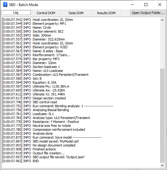

An optional additional parameter /UI
can be added to the command line to show the progress during automation and the output when finished.
> "C:\Program Files\Autodesk\Structural Bridge Design 2026\sbdw64.exe" /BM "C:\MyFolder\MyFile.json" /UI
This dialog is shown if the /UI
parameter is used.
